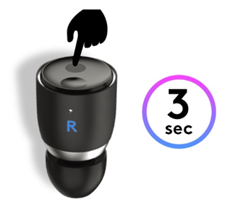

2. If both earphones’ LEDs are flashing white, then neither of them are waiting to pair. Touch the control surface on ONE earphone, it doesn’t matter which one, for about 3 seconds until the voice prompt says ‘waiting to pair’ and the LED flashes blue and white alternately. One earphone must be waiting to pair.

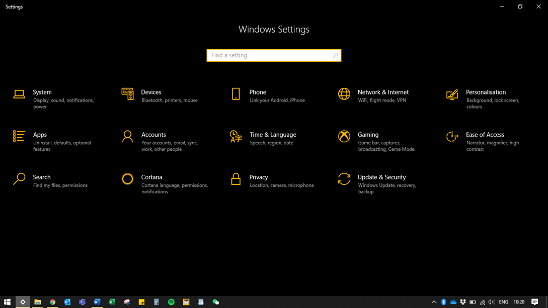

Step 3. Go to your PC's Settings by pressing the Settings gear icon on your control panel.
Step 4. Go into your Windows Settings and select Devices.

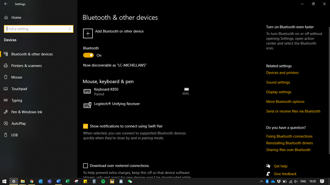

Step 5. Turn ON Bluetooth if it is OFF.

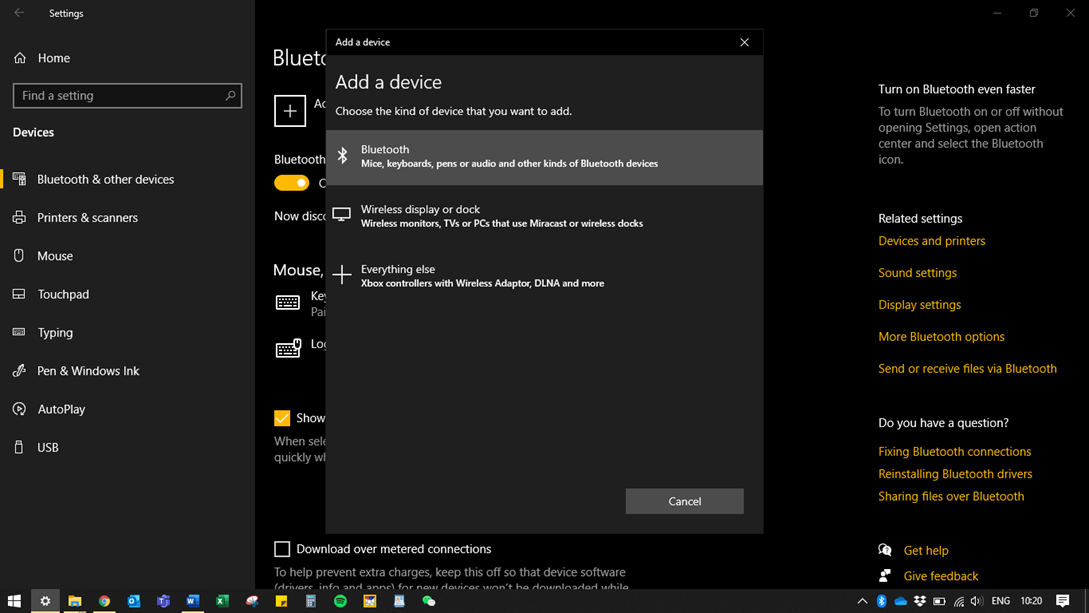

Step 6. Select Add Bluetooth or Other Device.
Step 7. Select Bluetooth.

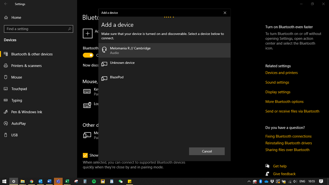

Step 8. Select Melomania 1/1+ from the Add a Device list.
You will see either Melomania 1/1+ L or Melomania 1/1+ R in the Add a device list. Ensure that the Melomania 1/1+ (L or R) has the headset icon next to it in the Add a device list. If you do not see the headset icon next to Melomania 1/1+ (L or R), press Cancel and try again.

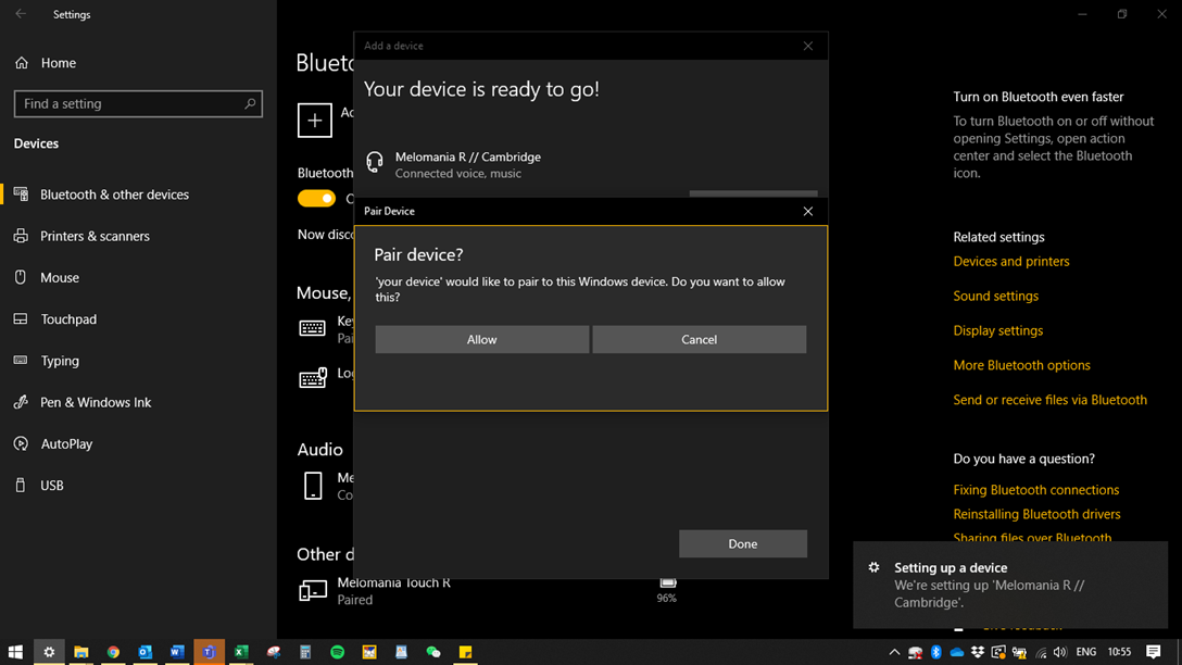

Step 9. Accept pairing request from secondary earphone.
Select Allow to proceed. You will hear the “Melomania Paired” and “Melomania Connected” voice prompt and the LED on the secondary earphone will flash white.

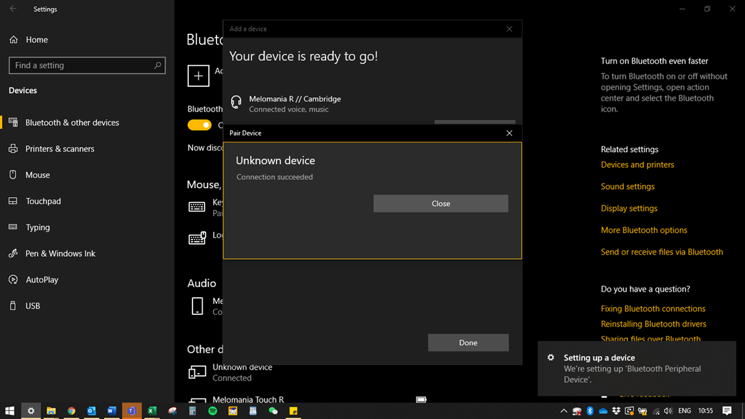

Do not select ‘Close’ yet. You will see the pop-up box will say ‘Setting up a device’: this is your secondary earphone.

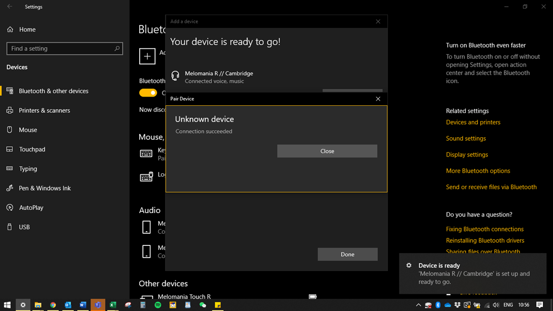

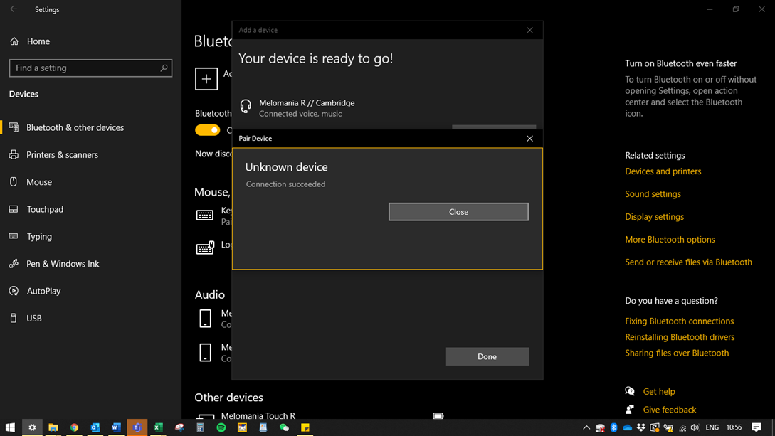

The pop-up box will now inform you that your primary earphone has been set up.
10. Select Close.
Step 11. Your Melomania earphones are now connected.

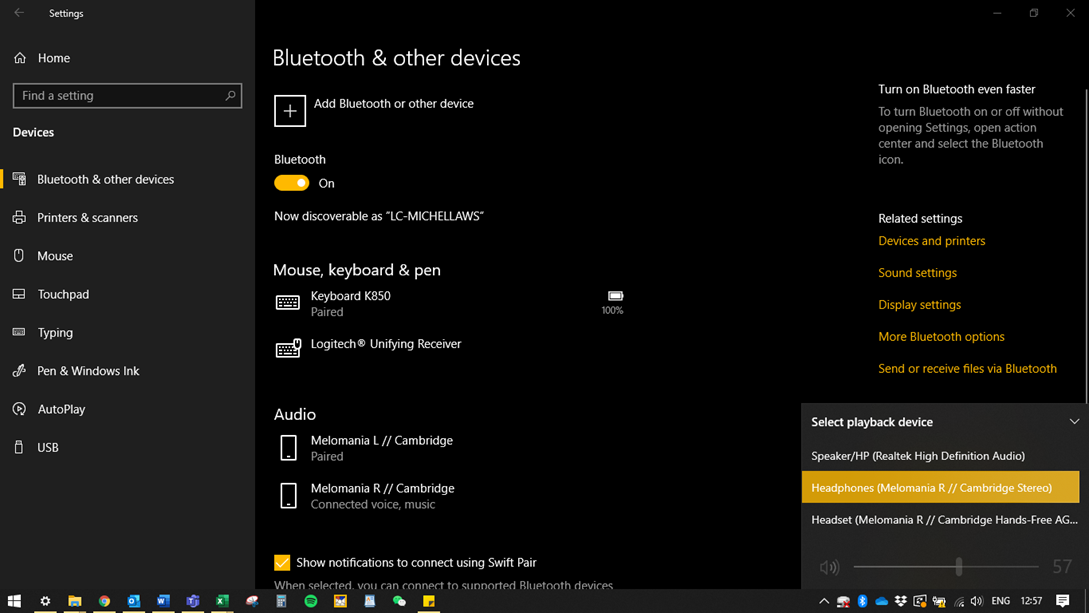

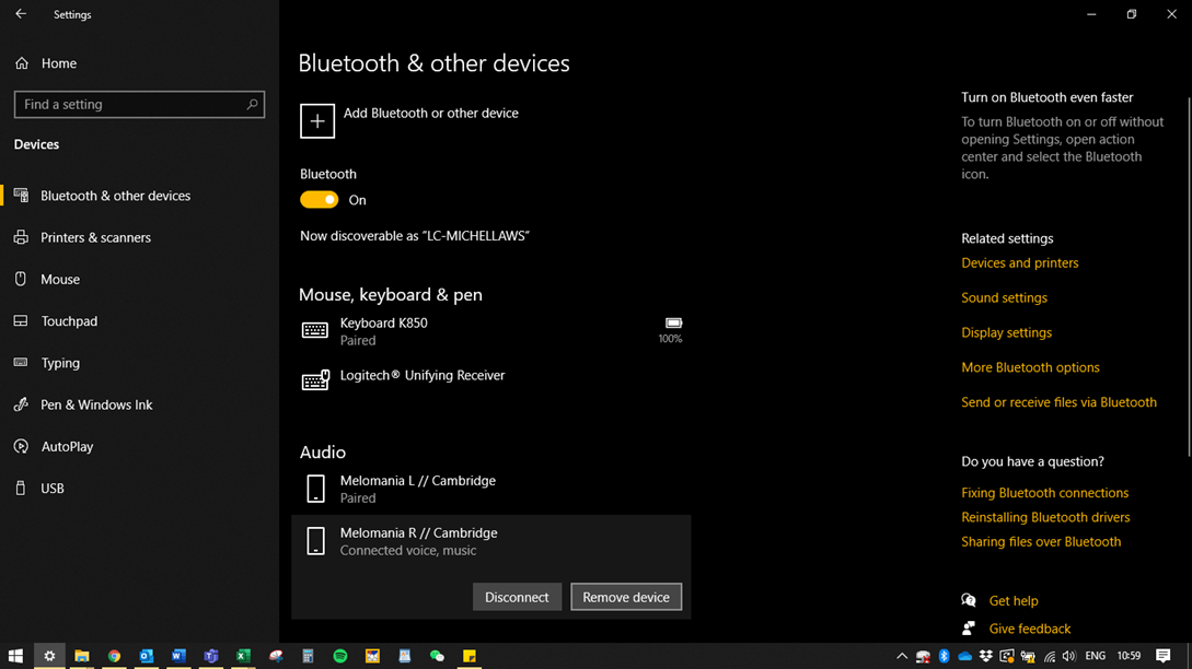

Step 12. Ensure your device output is correct.
On your task bar, click on the volume icon and ensure it is set to Headphones (Melomania 1/1+ R or L Stereo).
Headphones (Melomania 1/1+ R or L Stereo) is used for listening to music.
Headset (Melomania 1/1+ R or L Hands-Free AG Audio) is used for calls.
