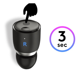

2. If both earphones’ LEDs are flashing white, then neither of them are waiting to pair. Touch the control surface on ONE earphone, it doesn’t matter which one, for about 3 seconds until the voice prompt says ‘waiting to pair’ and the LED flashes blue and white alternately. One earphone must be waiting to pair.

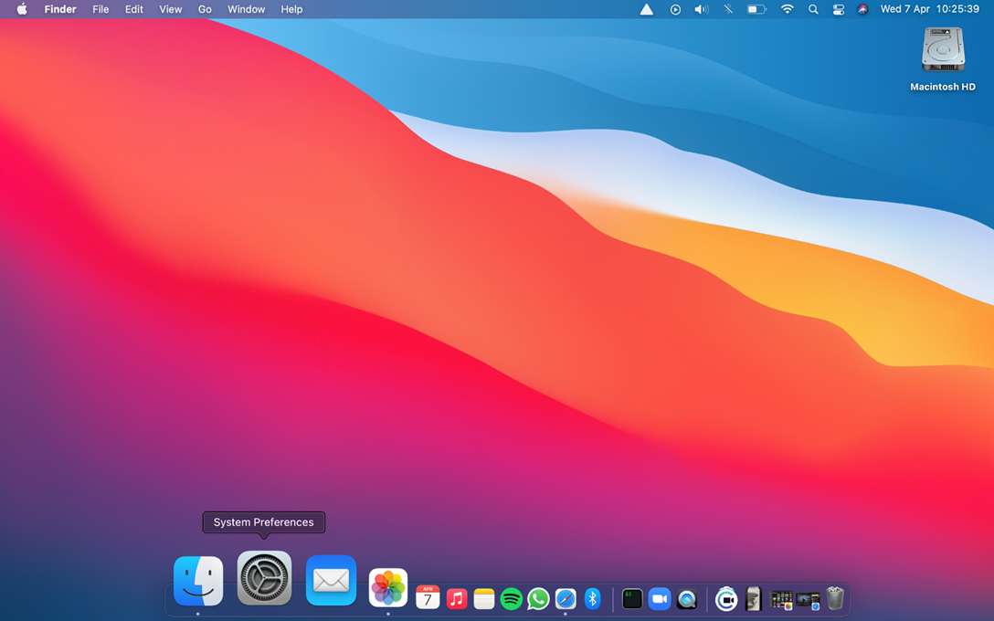

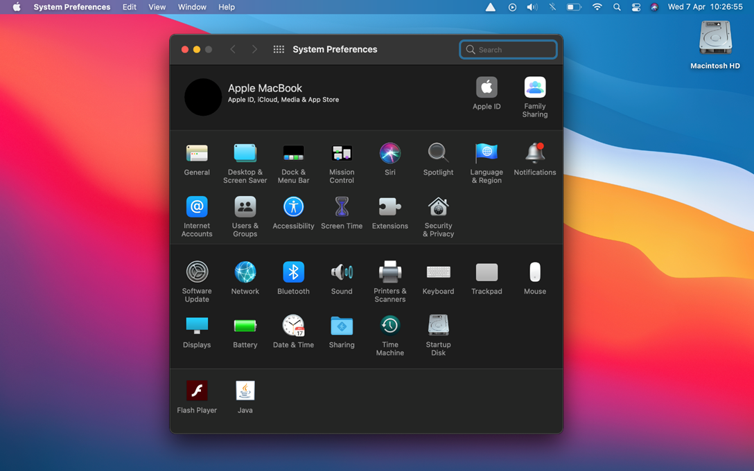

Step 3. Go to System Preferences.
Step 4. In your System Preferences, select Bluetooth.
Step 5. Turn ON Bluetooth if it is OFF.

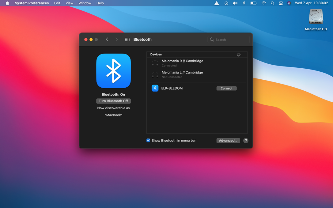

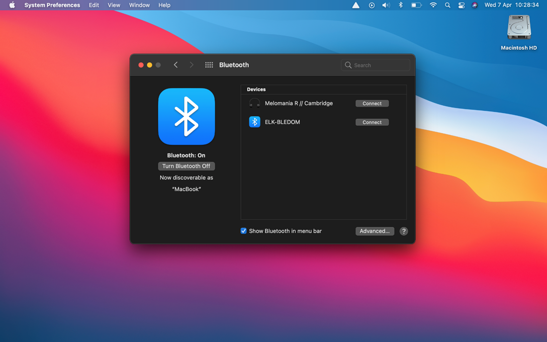

Step 6. Select ‘Connect’ next to the Melomania device.
You will see either Melomania 1/1+ L or Melomania 1/1+ R in the DEVICES list, select this. If you have manually enabled both earphones for pairing you will see them both in the DEVICES list, this is fine, just select either one of them.
Once selected you will hear the “Melomania Connected” voice prompt and the LED on the selected (primary) earphone will stop flashing blue and white, and will flash white only.

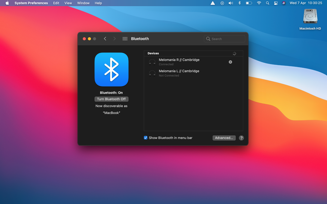

Step 7. Accept pairing request from secondary earphone.
Soon after pairing the primary earphone you will see a pop-up message requesting to pair the secondary earphone, press Connect. You will hear the ‘Melomania Paired’ voice prompt and the LED on the secondary earphone will flash white.
Step 8. Your Melomania earphones are now connected.

If Pairing is not successful and you need to start again.
1) In the Bluetooth settings Devices list press the 'X' next to the Melomania device.
2) Select ‘Remove’.
3) Repeat to forget the other earphone.
4) Continue with manual pairing from Step 5.
