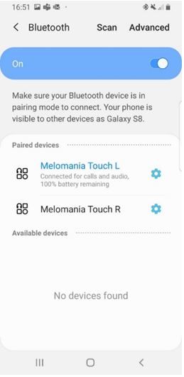

ANDROID SCREENSHOT

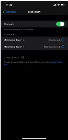

IOS SCREENSHOT
You can check which of the earbuds is the primary one by looking at your device's Bluetooth settings. The primary earbud will be the one "Connected" to your device just like the "Melomania L" in the screenshots above.
