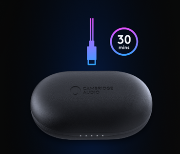

1. Charge new earphones for 30 minutes before pairing

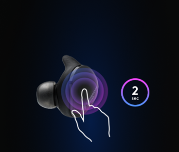

If the LED is unlit, then the earphone is OFF. Touch the control surface for about 2 seconds until the voice prompt says ‘power on’ and the LED flashes white. Both earphones must be powered ON.

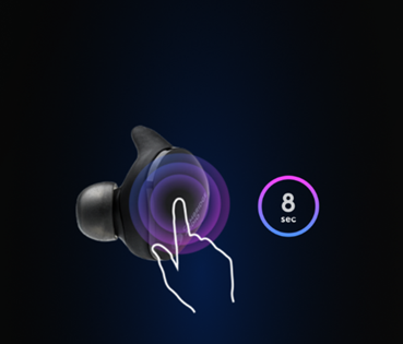

If both earphones’ LEDs are flashing white, then neither of them are waiting to pair. Touch the control surface on ONE earphone, it doesn’t matter which one, for about 8 seconds until the voice prompt says ‘waiting to pair’ and the LED flashes blue and white alternately. One earphone must be waiting to pair.

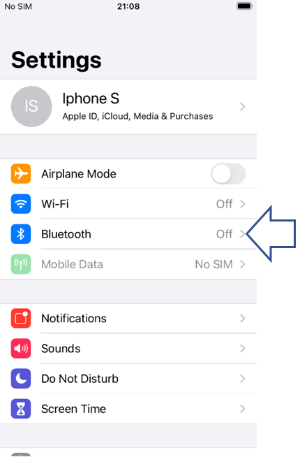

3. Go to Settings and select Bluetooth
4. Turn ON Bluetooth if it is OFF

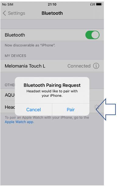

Soon after pairing the primary earphone you will see a popup message requesting to pair the secondary earphone, press ‘Pair’. You will hear the ‘Melomania Paired’ voice prompt and the LED on the secondary earphone will flash white.
You may see that in the pairing request message the secondary earphone is called Headset, this is normal, continue by pressing ‘Pair’.

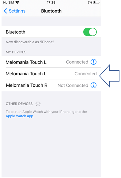

Once both earphones are correctly paired, you will see that the primary Melomania Touch (L in the example below) is shown as Connected and the secondary earphone (R in the example below) is shown as Not Connected.
In Bluetooth Settings, the secondary earphones Bluetooth Device Name may be shown as ‘Headset’, this is not unusual and is fine, do not try to reconnect it or edit the name.
You may see a second connection to the primary earphone (Melomania Touch R in the example below), this will not have the 'i' symbol. This is showing a data link, used by the Melomania App, to your earphones in addition to the audio link. This is normal, do not try to disconnect it.
