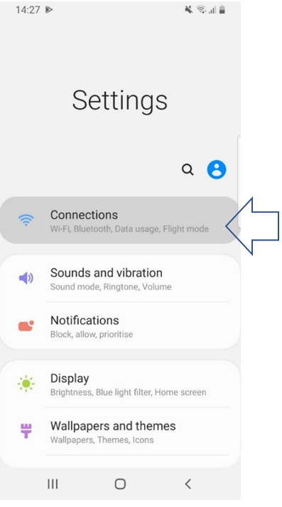

3. Go to phone Settings and select Connections

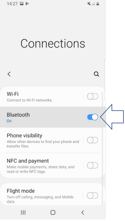

4. Turn ON Bluetooth if it is OFF

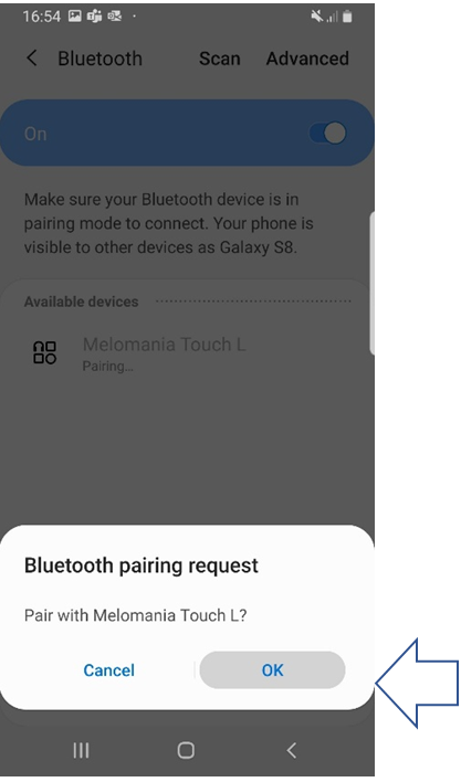

6. Select the Melomania Touch from the ‘Available devices’ list
You will see either Melomania Touch L or Melomania Touch R in the ‘Available devices’ list, select this. If you have manually enabled both earphones for pairing you will see them both in the ‘Available devices’ list, this is fine, just select either one of them.
If your Melomania Touch are on firmware version v2.1.0 or higher, then you will see both Melomania Touch L and Melomania Touch R, select ONE of these.
7. Accept the pairing request
Press ‘OK’.

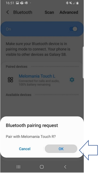

8. Accept pairing request from the secondary earphone
Soon after pairing the primary earphone, you will see a popup message requesting to pair the secondary earphone, press ‘OK’. You will hear the ‘Melomania Paired’ voice prompt and the LED on the secondary earphone will flash white.

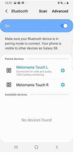

Once both earphones are correctly paired, you will see that the primary Melomania Touch (L in the example below) is shown as Connected for calls and audio, and the secondary earphone (R in the example below) is shown in the ‘Paired devices’ list.
