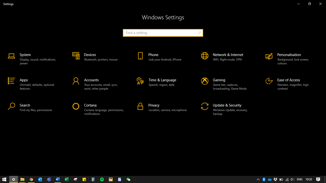

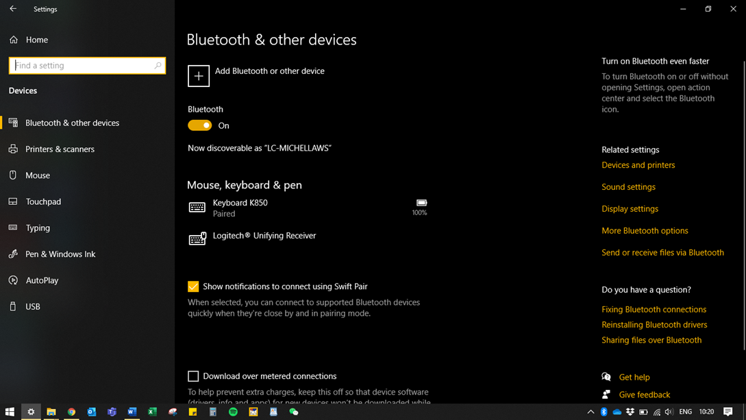

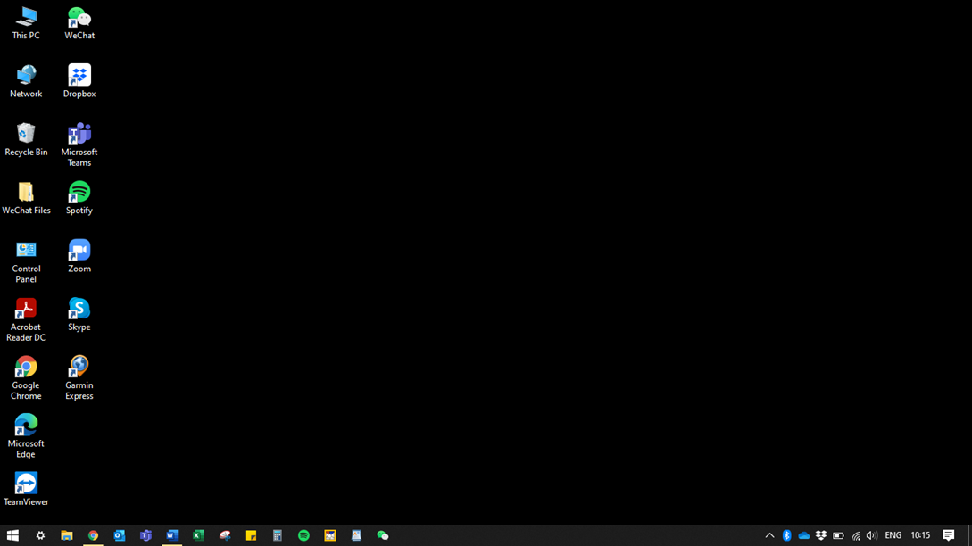

Step 3. Go to your Settings by pressing the gear icon on your control panel.
Step 4. Go into your Windows Settings and select Devices.

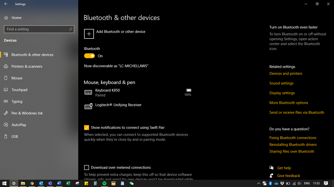

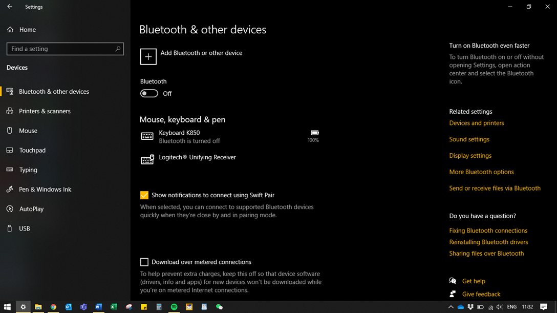

Step 5. Turn ON Bluetooth if it is OFF.

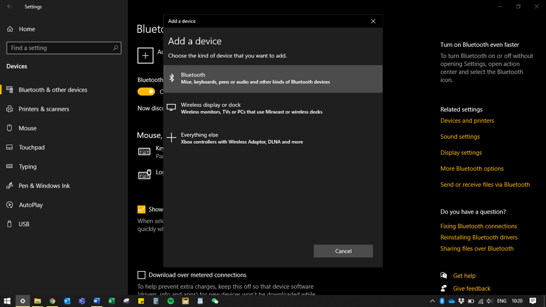

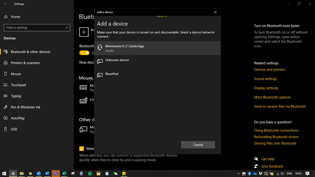

Step 6. Select Add Bluetooth or Other Device.
Step 7. Select Bluetooth.

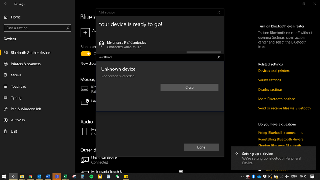

Step 8. Select Melomania Touch from the Add a Device list.

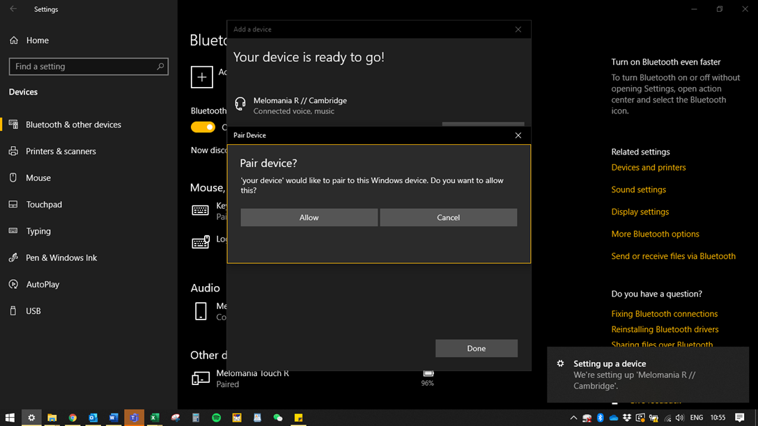

You will see either Melomania 1+ L or Melomania 1+ R in the Add a Device list, select this. Ensure that the Melomania 1+ (L or R) has the headset icon next to it in the Add a Device list. If you do not see the headset icon next to Melomania 1+ (L or R), press Cancel and try again.
Once you see the ‘Device is ready’ appear, proceed to the next step.

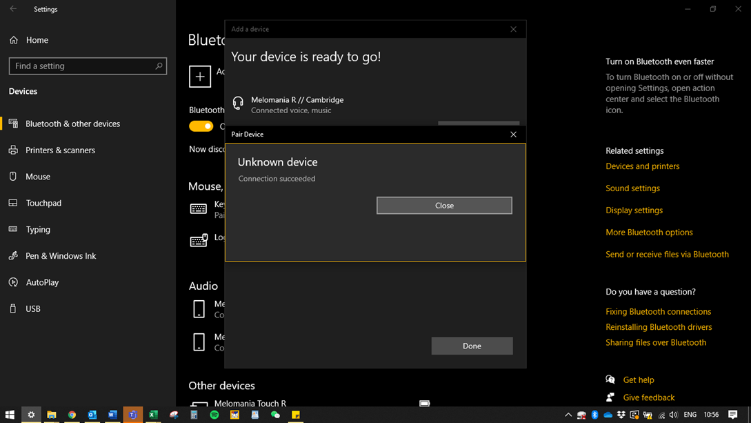

Step 9. Accept pairing requests from the secondary earphones.
Select ‘Allow’ to proceed. You will hear the “Melomania Paired” and “Melomania Connected” voice prompts and the LED on the secondary earphone will flash white.
Wait for the secondary Melomania Touch to connect to your laptop, you will notice a small pop-up box on the bottom right of your screen…

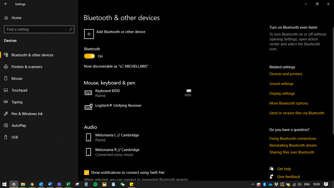

Step 10. Select Close.
Step 11. Your Melomania Touch earphones are now connected.

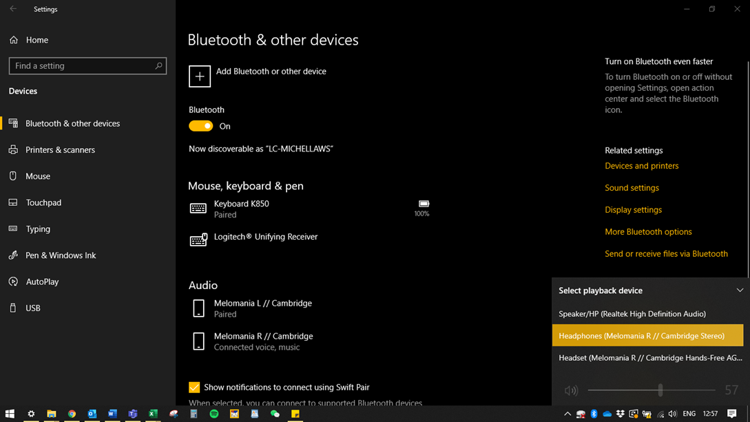

Step 12. Ensure your device output is correct.
On your taskbar, click on the volume icon and ensure it is set to Headphones (Melomania Touch R or L Stereo).
Headphones (Melomania Touch R or L Stereo) is used for listening to music.
Headset (Melomania Touch R or L Hands-Free AG Audio) is used for calls.

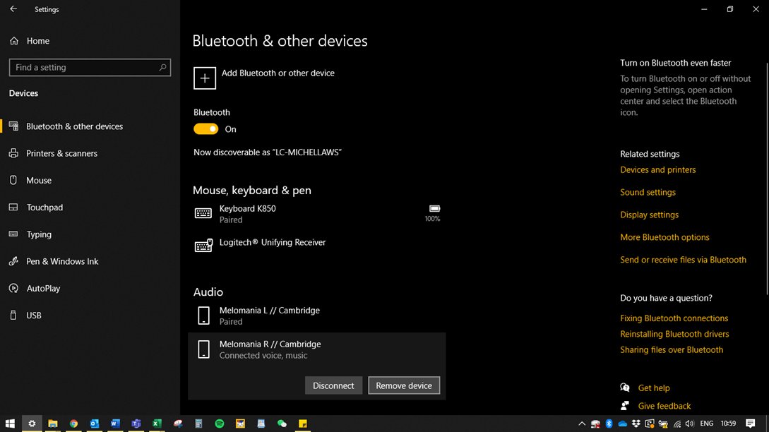

1) In the Bluetooth & other devices list, press on the Melomania device.
2) Select ‘Remove Device’.
3) Select ‘Yes’.
4) Repeat to forget the other earphones.
