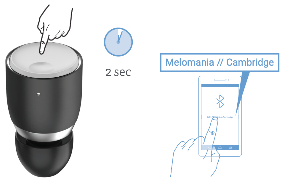

3. Pair to another phone or Bluetooth device (up to 7 can be stored)
1. Remove earphones from their case or pause music.
2. Press and hold either L or R button for 2 seconds to start pairing mode on your new device.
3. Select either “Melomania L // Cambridge” or " Melomania R // Cambridge" in the Bluetooth settings on your phone or other device and follow phone/device instructions to complete pairing.

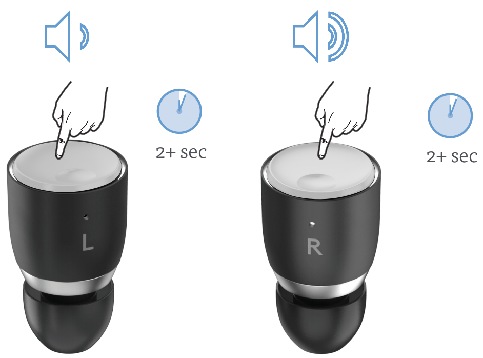

5. Volume control
When playing music; to increase the volume level press and hold the R button, to decrease the volume press and hold the L button.

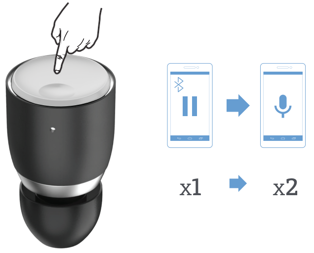

6. Voice assistant
To enable voice assistant, first single press L or R to pause music, then double press either L or R. Some phones/devices allow you to end Voice Assistant mode by pressing L or R earphone buttons, other phones/devices require you to end Voice Assistant on the phone/device itself.
7. Play/Pause
To pause music, quickly press either the left or right earphone button. To recommence playing, quickly press either earphone button again.
