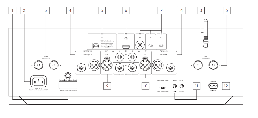

3. Run a USB Audio cable from the D5 input (5) on your EDGE A to a free USB port on your computer

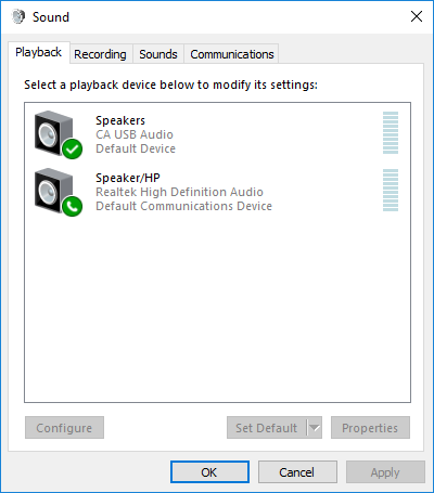

4. Upon turning on your EDGE A select the D5 input
You should notice that the EDGE A appears as 'CA USB Audio' within the playback section of your computer's Sound Settings (Control Panel > Sound > Playback).
Windows Playback devices
5. Make sure that the EDGE A is selected as your default playback Device with a green tick

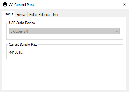

Once completed the EDGE A should also appear in the CA Control Panel.
EDGE A listed as a USB Audio Device within CA Control Panel.

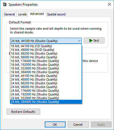

6. Right click the EDGE A within playback devices and select properties
Here navigate to Advanced where you can select the sample rate and bit depth to be used. We would recommend selecting the highest available. (This step is optional.)
EDGE A Advanced speaker properties

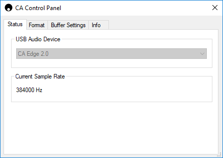

7. After doing this you will notice the 'Current Sample Rate' within the CA Control Panel should now change to reflect the settings you applied within the Advanced Speaker Properties
CA Control Panel showing selected Sample Rate.
