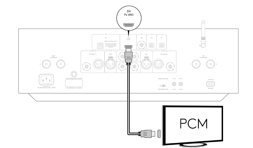

The EDGE A has an HDMI ARC (Audio Return Channel) input to allow you to create a connection to a TV that supports ARC function.
The TV ARC input is labelled as D4 on the front panel source selector.
Note: As the EDGE A is only able to decode a stereo PCM signal, you will need to ensure the audio output of your TV/App/Box’s settings are configured to PCM/Stereo. If you are unsure of how to amend your settings, please consult your TV/Box’s manufacturer.
