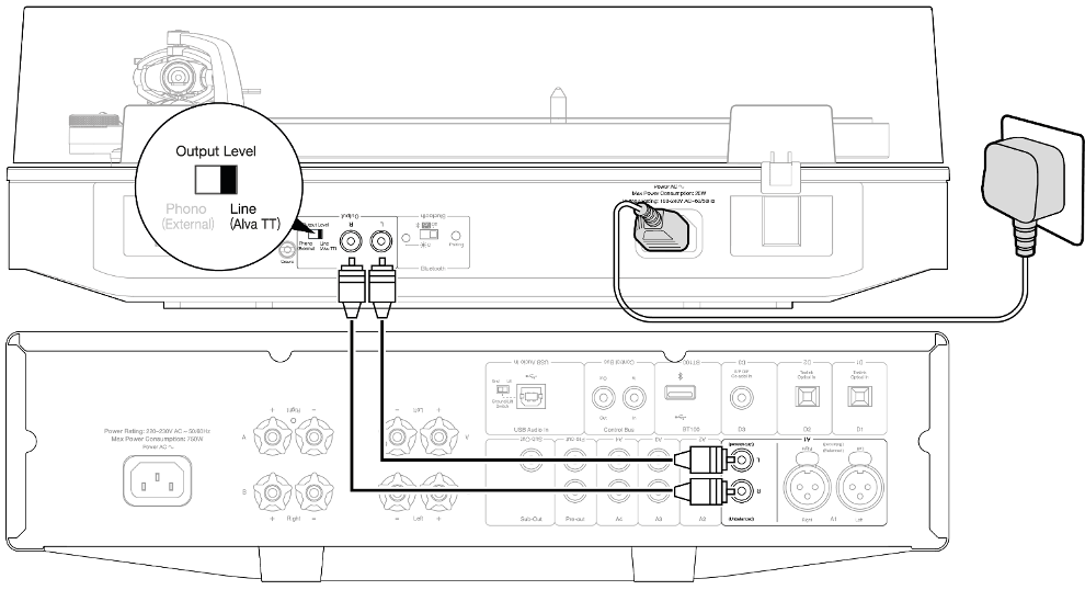

Switch the ‘output level switch’ to ‘line’.
Using high-quality RCA interconnects, connect the audio output of the Alva TT V2 to a line-level input on your amplifier.
Note: Do not connect to an external phono-stage with the turntable set to output at line level.
